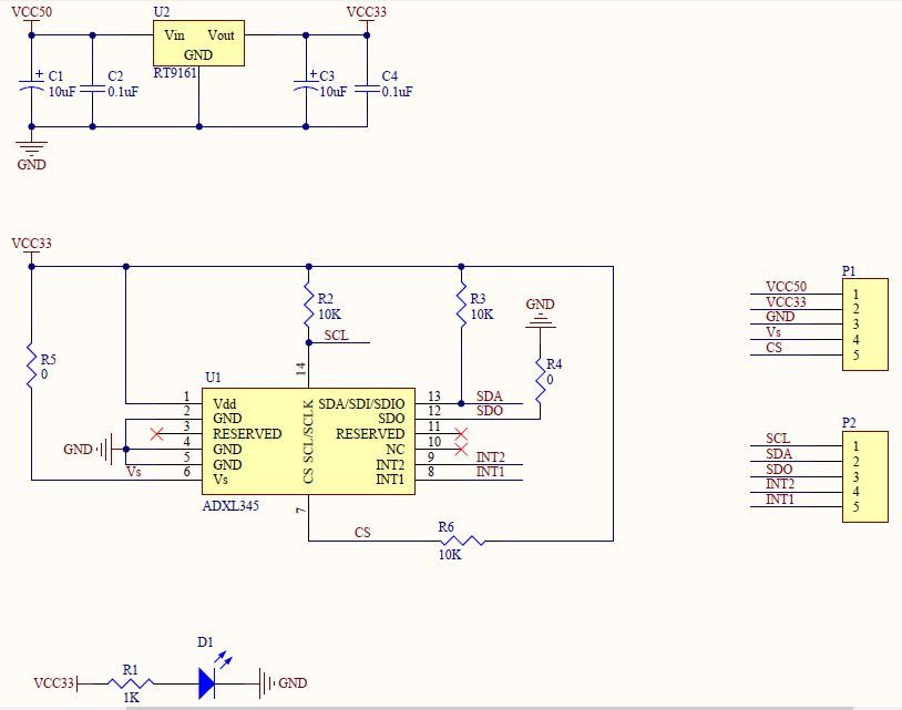

#define DATA_FORMAT (uint8_t)0x31
#define BW_RATE (uint8_t)0x2C#define POWER_CTL (uint8_t)0x2D#define FIFO_CTL (uint8_t)0x38#define DATAXL (uint8_t)0x32#define DATAXH (uint8_t)0x33#define DATAYL (uint8_t)0x34#define DATAYH (uint8_t)0x35#define DATAZL (uint8_t)0x36#define DATAZH (uint8_t)0x37#define OFSX (uint8_t)0x1E#define OFSY (uint8_t)0x1F#define OFSZ (uint8_t)0x20#define INT_ENABLE (uint8_t)0x2E #define INT_SOURCE (uint8_t)0x302017-10-31 2:15 PM
2017-10-31 2:18 PM
I am using STM32f4 discovery board,actually .SPI is working I controlled with Osciloscope also NRF24L01 is working and I2C is working same ADXL345 I mean device is strong.Also my new codes are here.

{ temp = ADXL345_Read_Single(hspi,INT_SOURCE); }while((temp & 0x80) == 0); ADXL345_Read_Multi(hspi,DATAXL,out,6);AccRaw[x_eksen] = (int16_t)(((uint16_t)out[1]<<8) | out[0]);
AccRaw[y_eksen] = (int16_t)(((uint16_t)out[3]<<8) | out[2]); AccRaw[z_eksen] = (int16_t)(((uint16_t)out[5]<<8) | out[4]);}//##################################################################################void ADXL345_Write_Single(SPI_HandleTypeDef *hspi, uint8_t reg, uint8_t data){ CS_LOW; HAL_SPI_Transmit(hspi,®,1,100); HAL_SPI_Transmit(hspi,&data,1,100); CS_HIGH;}//##################################################################################//##################################################################################uint8_t ADXL345_Read_Single(SPI_HandleTypeDef *hspi, uint8_t reg){ reg |= 0x80; // Okuma biti etkin // uint8_t out; CS_LOW; HAL_SPI_Transmit(hspi,®,1,100); HAL_SPI_Receive(hspi,&out,1,100); //HAL_SPI_TransmitReceive(hspi, &adr, &out, 1, 200); CS_HIGH; return out;}//##################################################################################//##################################################################################void ADXL345_Read_Multi(SPI_HandleTypeDef *hspi, uint8_t reg,uint8_t *out, uint8_t NumberOfByte){ reg |= 0xC0; // Okuma ve çoklu okuma bitleri etkin.0b1100-0000 // CS_LOW; HAL_SPI_TransmitReceive(hspi,®,out,NumberOfByte,100); CS_HIGH;}//##################################################################################//##################################################################################2017-10-31 2:19 PM
I am trying 2 days this.
