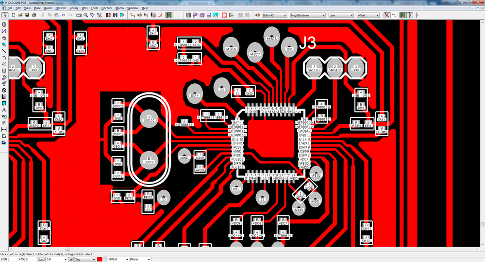

It's a custom board? Can you show your schematic? Looks not like F373 EVAL board.

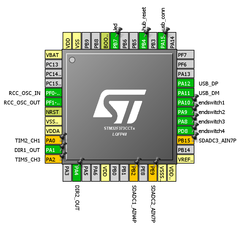

Yes, this is my own board. I didnt make sch file because of simplicity. I draw pcb looking at CubeMX pinout.

You can layout without a schematic?

I'm using CubeMX just to generate pinout. I don't use HAL.
