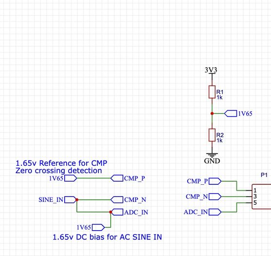

Okay so here is my example.
I have a voltage divider to generate 1.65v which is to be used for both the ADC DC bias as well as the CMP reference voltage for zero point.
But in the circuit below, we are actually connecting all signals together, which might lead to unexpected behavior on the comparator.
That's why I figured that using a buffer between ADC/CMP_N  and CMP_P would solve the potential issue
