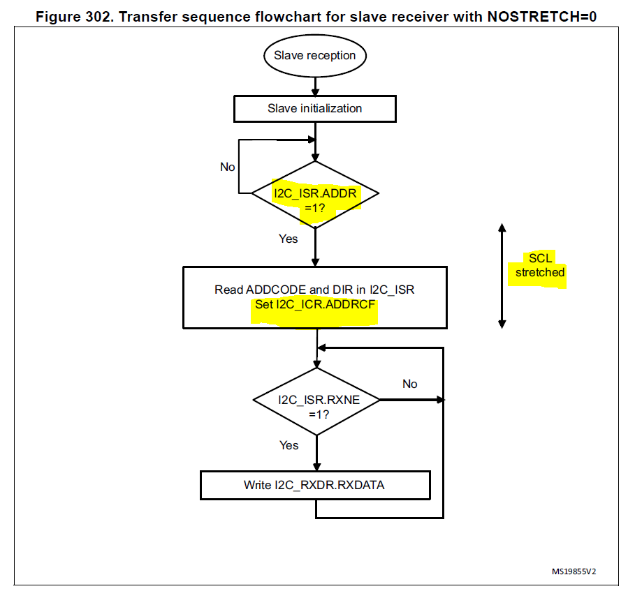

I think the RM does explain it. With NOSTRETCH=0, you get the behavior you described, where SCL is stretched to let the user code decide how it wants to proceed. If you don't want this, set NOSTRETCH=1. It even has flowcharts for these two scenarios. Doesn't that describe exactly what's happening?
