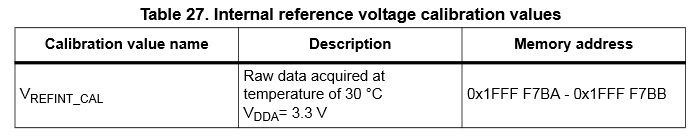

Hello Colleagues,
where the heck ist the calibration value to be found? The data sheet states: ''To improve the accuracy of the temperature sensor measurement,
each device is individually factory-calibrated by ST. The temperature sensor factory calibration data are stored by ST in the system memory area, accessible in read-only mode.'' Can anyone point me to the right loaction? rgds2014-07-22 8:24 AM
http://www.st.com/web/en/resource/technical/document/datasheet/DM00058181.pdf
