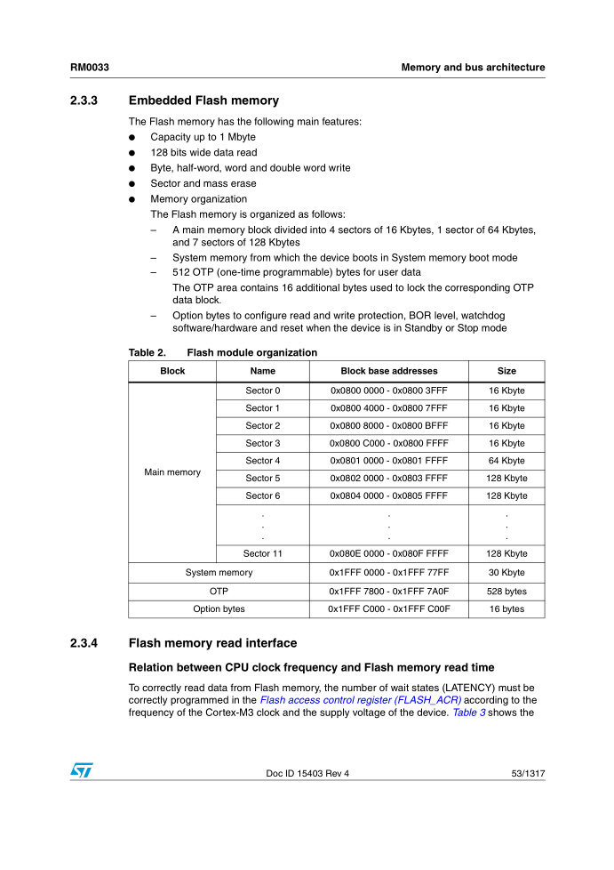

I am porting some code from stm32f105 to stm32f205.
(from stm32f2xx_hal_flash_ex.h)
/** @defgroup FLASHEx_Sectors FLASH Sectors
#define FLASH_SECTOR_0 0U /*!< Sector Number 0 */
#define FLASH_SECTOR_1 1U /*!< Sector Number 1 */
#define FLASH_SECTOR_2 2U /*!< Sector Number 2 */
#define FLASH_SECTOR_3 3U /*!< Sector Number 3 */
#define FLASH_SECTOR_4 4U /*!< Sector Number 4 */
#define FLASH_SECTOR_5 5U /*!< Sector Number 5 */
#define FLASH_SECTOR_6 6U /*!< Sector Number 6 */
#define FLASH_SECTOR_7 7U /*!< Sector Number 7 */
#define FLASH_SECTOR_8 8U /*!< Sector Number 8 */
#define FLASH_SECTOR_9 9U /*!< Sector Number 9 */
#define FLASH_SECTOR_10 10U /*!< Sector Number 10 */
#define FLASH_SECTOR_11 11U /*!< Sector Number 11 */am i missing something here?
this is very incovenient because i dont have enough ram to copy in a table the part of the sector i dont want to be erased before erasing it.

The 'F2 (and 'F4) FLASH is partitioned into non-uniform sectors. See RM.
Yes, it is, but that's the price you pay for large FLASH on smaller piece of silicon.

2021-04-07 5:45 AM
> It's a little trickier when you want to use the flash as eeprom to store settings, but can be done.
> Choose a page with a size that can fit into your ram, you need to copy the page into it, because to store new data you must first erase it.
I personally prefer using two sectors for this purpose - one holds data while the other is being erased.
This, of course, is application dependent. You may also consider using the BKPSRAM with battery, external serial EEPROM/FRAM/FLASH...
