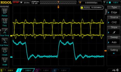

All theory is gray - so lets check on H563 nucleo board : 8MHz HSE (from st-link) , on H563 -> MCO (100MHz PLL/10 -> 10MHz out (yellow))
Screenshot is overlay from many traces (50 or so, set screen persistence > 0,5 sec);
so can see fixed and constant relation from (triggered) blue 8MHz to (untriggered) yellow 10MHz.
What we really can see here: how good or bad is the PLL design, giving some more or less jitter;
here clear below 1 ns , so with this fast and dirty check indicating : fine PLL design.
ed

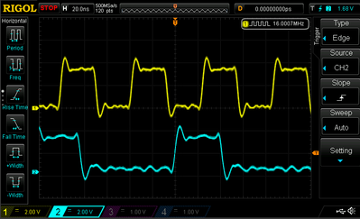

And here -just for fun- setting PLL to even factor, to get 16MHz on mco:
(also many traces overlay) See fixed phase and frequency relationship. :)
