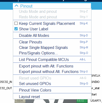

Hello @rndkd1
For the pinout Compatibility, i suggest you to create a project based on you STM32F2 MCU on the STM32CubeMX. Then, use the generator of the list of pinout compatible that will give you a list of MCU that are compatible with your original one:
Best Regards.
STTwo-32
I generated the list, and I found STM32F407ZG in it.
