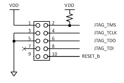

Hi All
Could anyone tell me whether I could using below 10-pin port as JTAG interface for STM32F205xx with J-Link debugger? Thanks!2014-11-09 7:37 PM
Yes, looks like a standard Cortex 10-pin 0.05'' JTAG/SWD Connector Pinout
