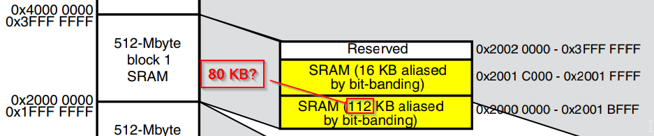

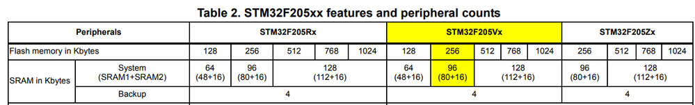

we are using the STM32F205VCT7 controller which should have 256k embedded flash and 96k embedded sram.
I am wondering now where the available SRAM is mapped.
It seems to be splitted into SRAM1 and SRAM2 where SRAM2 starts at 0x2001C000 and goes up to 0x20020000
But all memory mappings i found are showing the full 128k SRAM.
I have not found any memory mapping for the smaller devices like the STM32F205VC.
Is there 96k memory from 0x2000000 up to 0x20017FFF and then 32k ''nothing''.
Or is there a gap between SRAM1 and SRAM2?
==> SRAM1 from 0x20000000 to 0x20013FFF (80k)
==> SRAM2 from 0x2001C000 to 0x2001FFFF (16k)
==> nothing from 0x20014000 to 0x2001BFFF
And what will happen, if a non existing memory is accessed?
Does anyone know where to find this information?
Thank you.
Regards
Stefan

At least all STM32F2 are the same die. See the <Die> entry in the cubemx STM32F2XX..xml files. So at least all STM32F2 are produces with the same amount of memory. However the smaller chip announcing less ram than the big chip have:
- perhaps the surplus memory disable by some fuse
- maybe are labeled as a small chip as memory was tested bad or not tested at all
- or mybe the surplus memory functioning perfect.
SRAM2 however is always mapped at 0x2001C000, see the stm32f2XXxx.h headers.

2018-01-29 8:44 AM
The memory starting at 0x20000000 up to the announced size in the datasheet must have been tested good by STM. If you only use that part, you are on th safe side.
2018-01-29 11:38 AM
This is a topic that has come up before. ST has described the memory regions in two different inconsistent ways in linker scripts, and projects. SRAM2 has different connectivity via the bus matrix, but on the other hand no description of the parts says the 96KB is not continuous. Having a hole in the main SRAM would be highly undesirable.
The conclusion of the prior discussions, as I recall, is that it is safe to assume the die has 128KB of SRAM, and that it is tested/functional. The die also has 1MB of FLASH, but no tester time has be applied to the sectors beyond 256KB on the 256KB marked part. A location in the ROM (OTP/FLASH) has the FLASH size programmed along with the device unique number containing die location and batch details.
