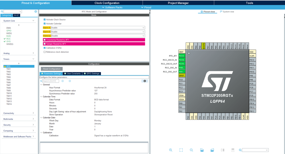

I have connected external crystal of 32.768 KHz to STM32F205RG for RTC time keeping purpose. I have also enabled RTC output on pin PC13. Below is my code for RTC Initialization ...

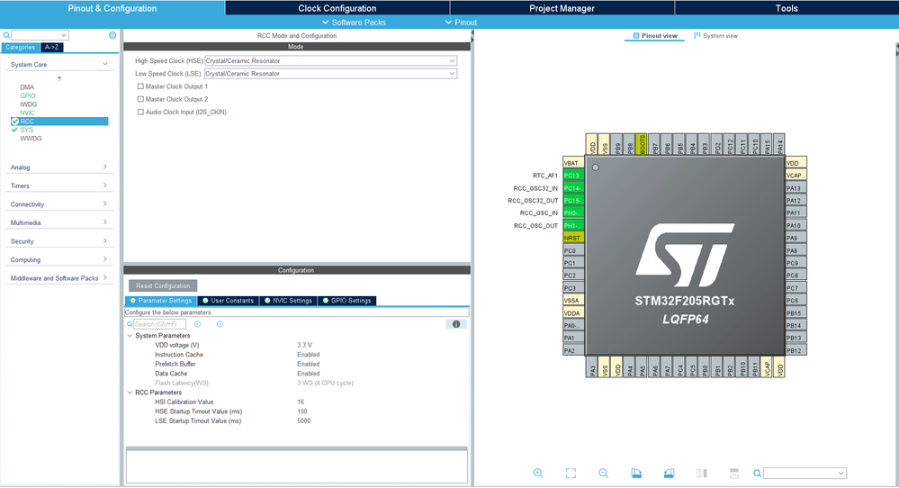

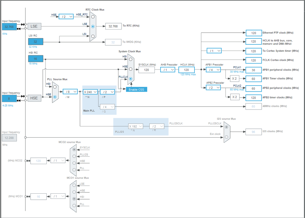

I have used cube for code initialization. I am attaching the screen shots of the cube for better understanding.
