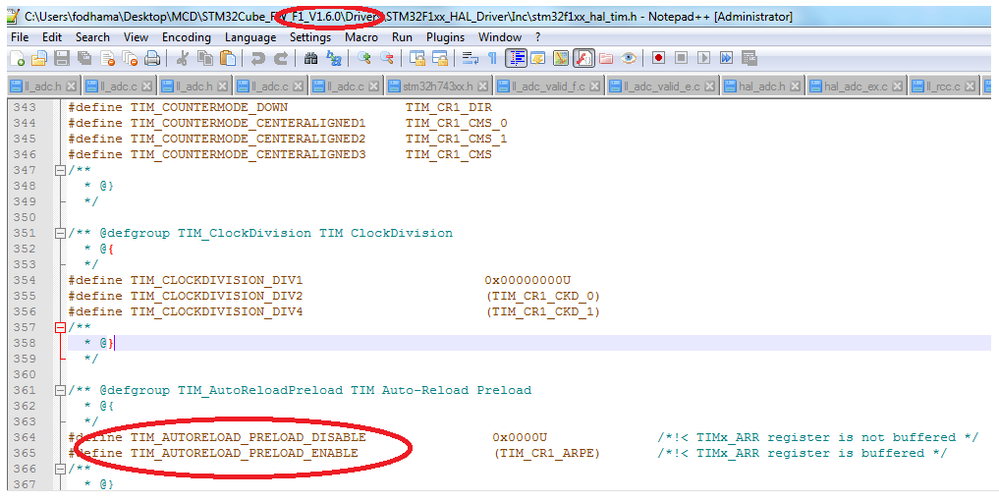

However, one more issue: new bug appeared in other place, where timer intiailizes:
htim4.Init.AutoReloadPreload = TIM_AUTORELOAD_PRELOAD_DISABLE;
and compiler says 'Field 'AutoReloadPreload' could not be resolved tim.c /BatteryTester_CUBE_HAL/Src line 62 Semantic Error' version ofstm32f1xx_hal_tim.h file (generated by CubeMX) is v1.0.4 ;I checked whether it's lastest version, and looks like no. (lastest is v1.1.1)if I delete this line, code works fine..

Hello
V.Jurijs
,I checked your ioc file, I can reproduce the issue you highlighted.
However, I see that you are working onSTM32Cube FW_F1 V1.4.0, and in FW_F1 V1.6.0, the issue is not present as TIM_AUTORELOAD_PRELOAD_ENABLE is defined :
Please, use FW_F1 V1.6.0.
BR. Jeanne
