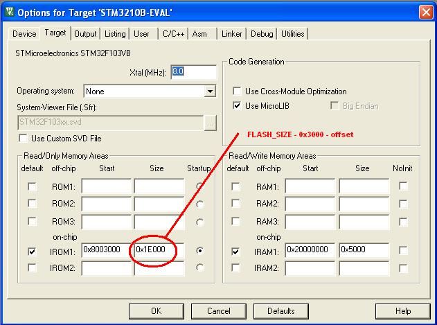

Look the ''stsw-stm32121_USB\STM32_USB-FS-Device_Lib_V4.0.0\Projects\Device_Firmware_Upgrade\binary_template'' use same method.
Bootloader ==> 0x08000000 to 0x08003000 Application ==> 0x08003000 to 0x08020000 In the main function set the Vector Table base location at 0x3000: NVIC_SetVectorTable(NVIC_VectTab_FLASH, 0x3000); The option target for application is:2014-06-26 5:03 AM
Previously: The VECT_TAB_OFFSET must be equal 0x7000 ( 0x8000 - offset) else not function! So 0x7000 when it's 0x8000 is consistent with this? 64K-0x8000 = 0x9000! And the binary generated with a ResetHandler at ~0x08007000 when the linker is set at 0x08008000
