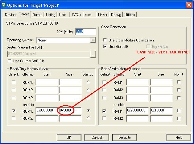

Thanks ________________ Attachments : Option_Application.JPG : https://st--c.eu10.content.force.com/sfc/dist/version/download/?oid=00Db0000000YtG6&ids=0680X000006I0fx&d=%2Fa%2F0X0000000beh%2F79pSp4wlNuLzYAqyevmpTo2AVFX.w1Shamk85PVWisE&asPdf=false2014-06-25 2:46 AM
I solved!
The solution consist in settings the parameters in application code: 1) In SystemInit function the ''VECT_TAB_OFFSET'' must be equal as 0x7000 (application address - 0x1000); 2) The Application needs to be compiled for the higher address (0x08008000) with size equal 0x9000 (flash size - VECT_TAB_OFFSET); 3) The first istruction in the main must be NVIC_SetVectorTable(NVIC_VectTab_FLASH, 0x8000).2014-06-25 3:22 AM

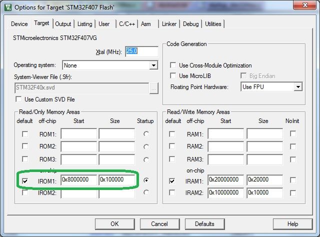

The VECT_TAB_OFFSET must be equal 0x7000 ( 0x8000 - offset) else not function! This for application.
You need configure the option device:We’re moving the ST Community to a new platform to give you a better and more reliable community experience.
