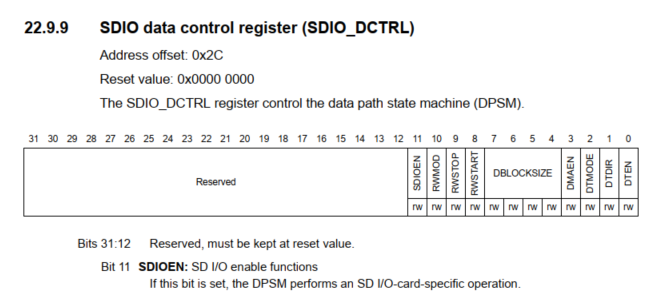

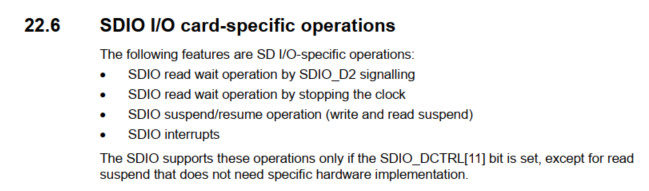

My current plan is as follows:
Among other things, I do not exactly know how to implement the interrupt from the SD. for example:
Do you have any references for resources which will help me learn about setting up interrupts and using that to manage cache and SD card access.
