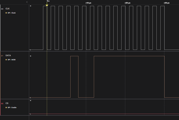

I'm getting a clock, and I'm getting data, but something is still going on with PA15. I think it has to do with that conflict on reference manual page 699. Does anyone see anything wrong with how I'm disabling the JTAG and trying to use PA15?

> // init PA15 NSS - Mode = 01 (10Mhz output), CNF = 10 = alternate function push-pull...ref manual pg 171
> GPIOA->CRH |= (GPIO_CRH_MODE15_0 | GPIO_CRH_CNF15_1); //***(VERIFIED, MODE goes to 01 (output 10MHz), and CNF goes to 10 (alternate function push pull)
If PA15 is configured as AF, you can't control it with BSRR. It needs to be set as a regular GPIO output. Hardware master NSS mode isn't very useful on this chip.
2025-08-06 11:26 AM
Ok, awesome, that did it. All is good for now, I think. Thank you very much!
