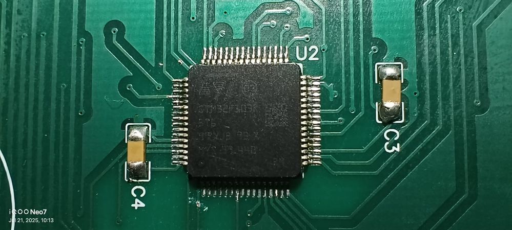

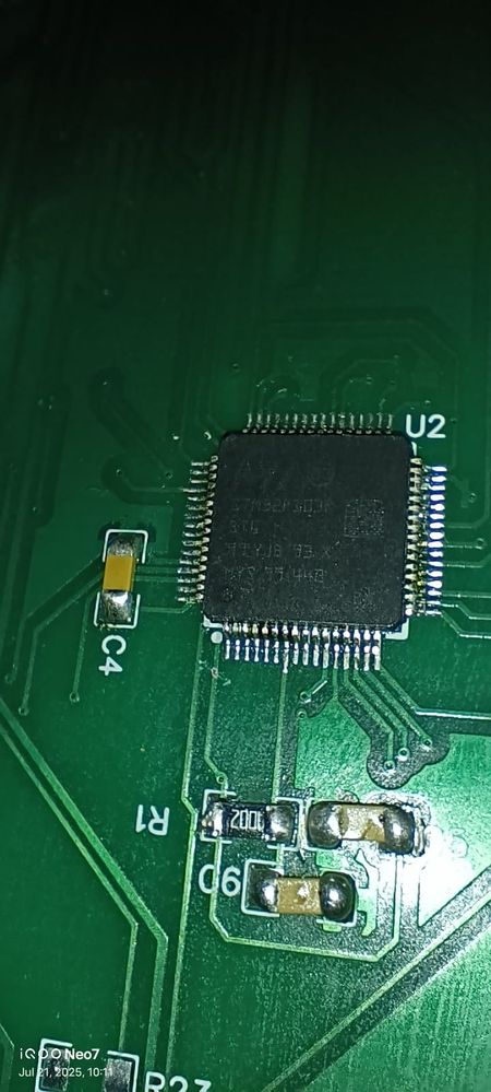

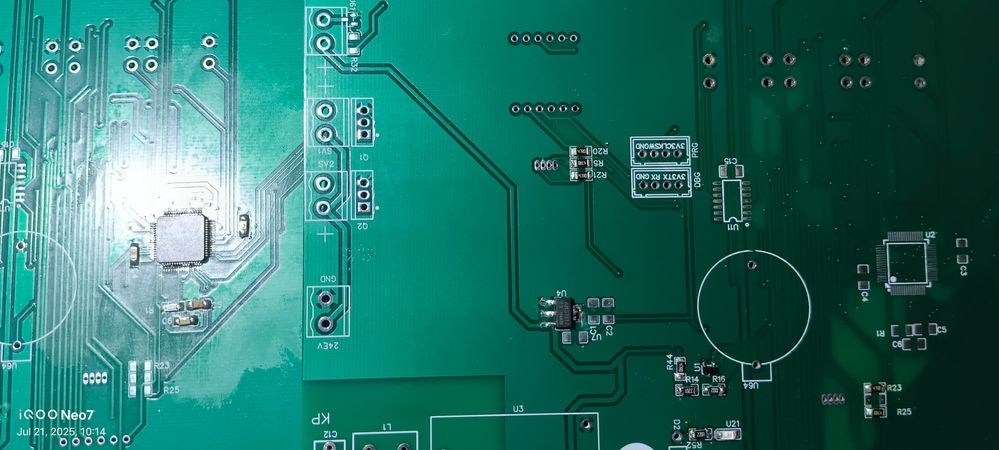

I have designed a custom PCB using STM32F103RBT6 and I’m facing a serious issue:
The MCU is not getting detected by the programmer.
Symptom:
When connecting via SWDIO, SWCLK, 3.3 V, and GND, both STM32CubeProgrammer and ST‑Link Utility fail to detect the target.
Power rails are verified: 3.3 V present at VDD pins, proper decoupling capacitors placed close to supply pins.
No shorts observed on the board.
Important hardware details:
Boot0 pin (on my design) is directly tied to GND by mistake – I’m wondering if this could block programming or reset behavior.
NRST pin has a 10 kΩ pull‑up to 3.3 V as recommended.
BOOT0 is pulled low (GND) on the board without Resistor, any problem?
Any advice would be greatly appreciated!
schematic snippet attached.
Thank you in advance for your help.

Measured Voltage is 3.329V on pull up with resistor and without resistor. Also i have connected VDD to VBAT, still controller is not responding to programmer same error.
2025-07-24 5:37 AM
Connected VDDA directly to VDD, it worked! means TL431 was not able to supply enough current required for operation.
