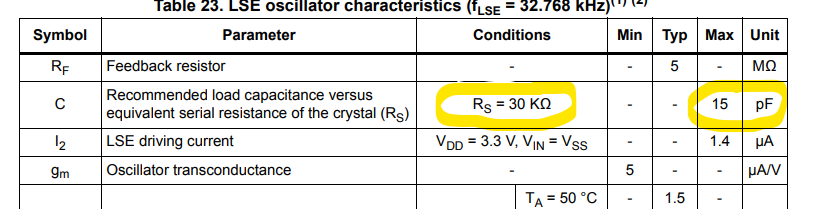

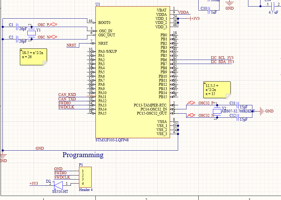

Here is my Schematic. I'm using ABS07-32.768khz with 12.5pF load Capacitances and the equivalent series resistance is 70kR. I took Cstray as 5pF that's why CL1 and CL2 are 15pF for now, but there are some troubles with this design.In the datasheet of stm32f103x, states that:
Equivalent resistance value 30kR and load capacitances of 15pF. I'm going to use 70kR in my design. Can this one cause me some problems.

See AN2867
Pretty sure the F1's really wants 6-7pF crystals, not 9 or 12pF ones.
Perhaps look a NUCLEO, EVAL and DISCO board BoM for working combinations.
