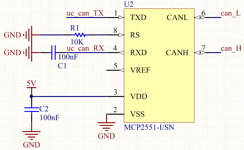

I forgot to say that, I used MCP2551 as CAN transceiver and I mounted this IC on the board like this(forget 100nF in RX, I hadn't assign true value for it at that time):
and besides, I tested my code at loop-back mode in which, apparently, there is no need for external electrical connections, but I didn't get any result

No clive, but as I responded to T.J., I even tested the CAN in loop-back mode and I didn't get any result
