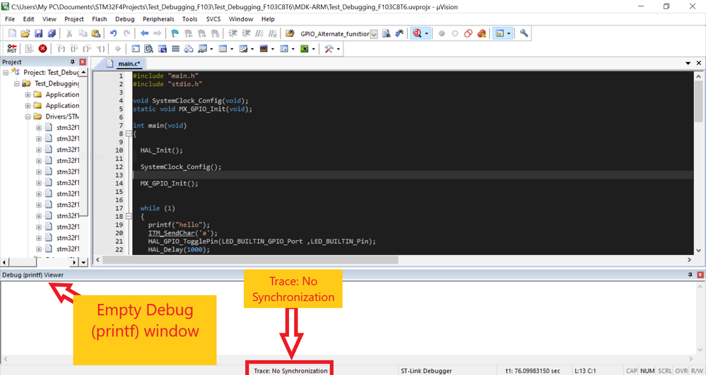

I'm working with the
I'm trying to debug a simple application with the printf() function
#include "main.h"
#include "stdio.h"
int main(void)
HAL_Init();
SystemClock_Config();
MX_GPIO_Init();
while (1)
printf("hello");
ITM_SendChar('a');
HAL_GPIO_TogglePin(LED_BUILTIN_GPIO_Port ,LED_BUILTIN_Pin);
HAL_Delay(1000);
void SystemClock_Config(void)
RCC_OscInitStruct.OscillatorType = RCC_OSCILLATORTYPE_HSI;
RCC_OscInitStruct.HSIState = RCC_HSI_ON;
Error_Handler();
RCC_ClkInitStruct.SYSCLKSource = RCC_SYSCLKSOURCE_HSI;
RCC_ClkInitStruct.APB2CLKDivider = RCC_HCLK_DIV1;
if (HAL_RCC_ClockConfig(&RCC_ClkInitStruct, FLASH_LATENCY_0) != HAL_OK)
Error_Handler();
__HAL_RCC_GPIOC_CLK_ENABLE();
__HAL_RCC_GPIOD_CLK_ENABLE();
__HAL_RCC_GPIOA_CLK_ENABLE();
HAL_GPIO_WritePin(LED_BUILTIN_GPIO_Port, LED_BUILTIN_Pin, GPIO_PIN_RESET);
GPIO_InitStruct.Pin = LED_BUILTIN_Pin;
HAL_GPIO_Init(LED_BUILTIN_GPIO_Port, &GPIO_InitStruct);
void Error_Handler(void)
#ifdef USE_FULL_ASSERT
#endif
/************************ (C) COPYRIGHT STMicroelectronics *****END OF FILE****/But it's not working when I start the debugger and I open the printf window it's empty and and I noticed a message below on Keil µVision "Trace: No Synchronization"

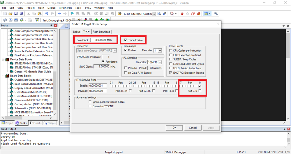

At first look at the problem seems like your code is missing:
In order to activate the ITM trace (printf) you need to add the fputc function definition just after the main function in your code as below:
Write character to Serial Port
int SER_PutChar (int c) {
ITM_SendChar (c);
return (c);
int fputc(int c, FILE *f) {
return (SER_PutChar(c));
}You can add it in the main.c file, or do it in a separate file, usually called Retarget.c for MDK-ARM.
This should work, if not make sure you use the correct "core clock" in the MDK-arm options.
Also you can ceck with the User manual in case there is a hardware modification (switch, SB etc)

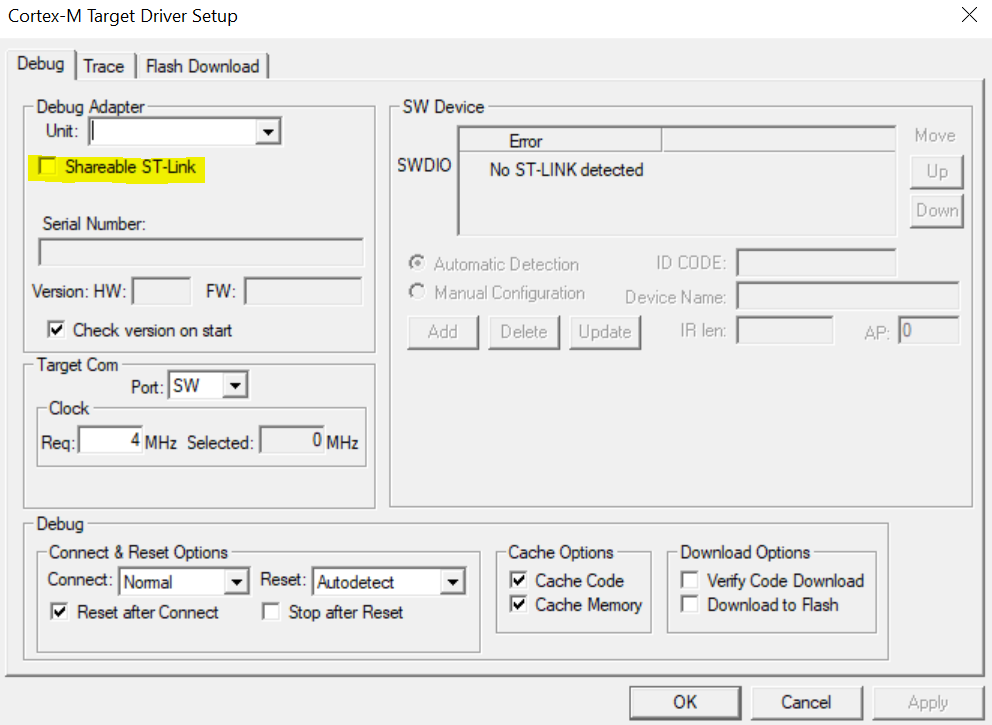

PS: The SWV is not supported when using ST-LINK Shared mode, so make sure it is not checked as in the photo I attached.

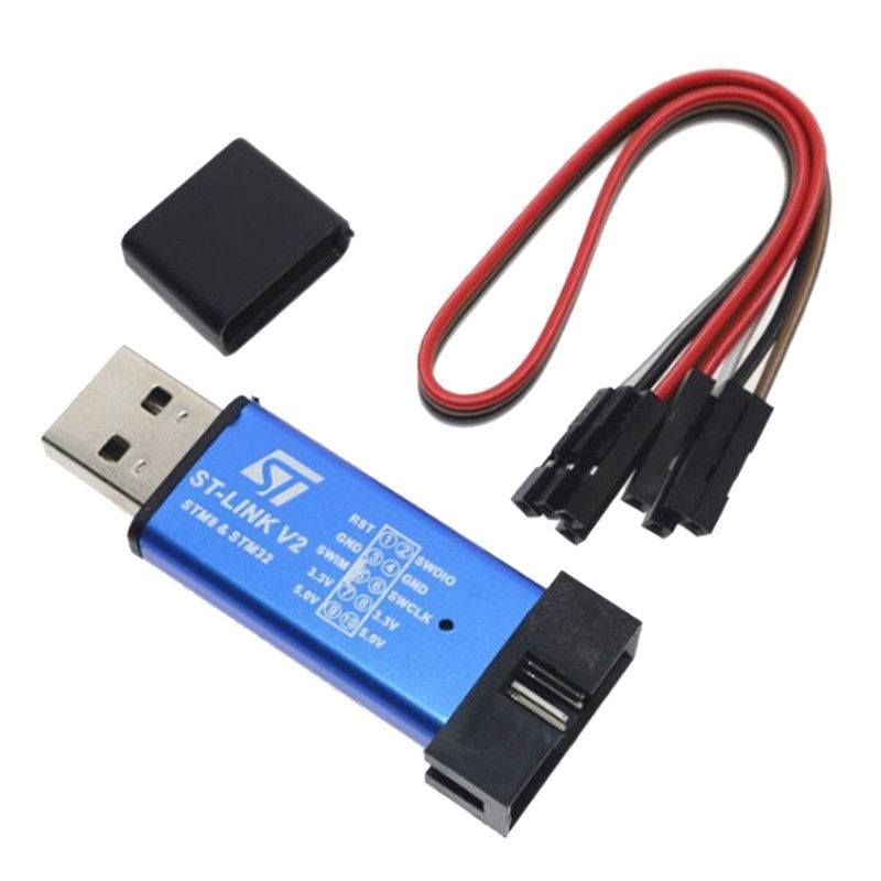

I tried what you advised me, but it also doesn't work, However I tried with a stm32 discovery board with an integrated ST-LINK and it worked, I deduce that the ST-LINK that I used is a cheap Chinese one (on the photo above) is not compatible with the TRACE.
Regards.
