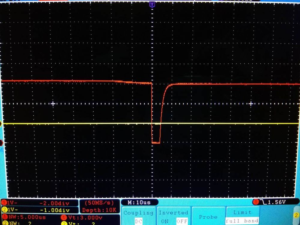

What re the SDA/SCL waveforms when looking by an oscilloscope or logic analyzer?

Posted on March 01, 2017 at 21:11
KIC,
that's no start/stop. Although the marks are barely visible, the yellow line is clearly permanently at zero. It means, the I2C machine attempts to do a START but as one of SDA/SCL is permanently low, it can't do that and gives up. I bet there's some error in the registers; I don't Cube so I don't know how to detect that in that realm.
SIRI.PISIT
find out why is the signal corresponding to the yellow line at zero, first. Even without any attempt to do I2C, after pins initialization, both pins shall be at one. You init them as open-drain, AF mode, properly chosen AF; and you do have external pullups?

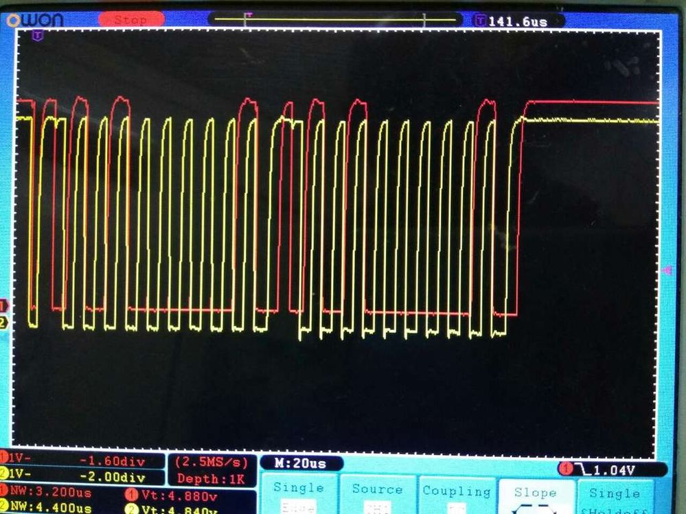

The chip slave address A0 is NACK => either the slave address is wrong, or bad soldering, or SDA/SCL connection is wrong. If possible, probe the EEPROM package pins and make sure it has supply and ground ok.

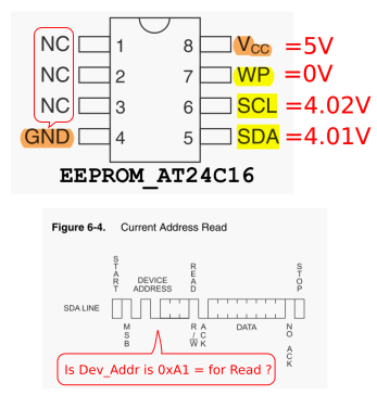

I think my soldering is ok, i checked  :)
and this is datasheet of EEPROM
but now, i don not understand
what is mistake ??
T_T!

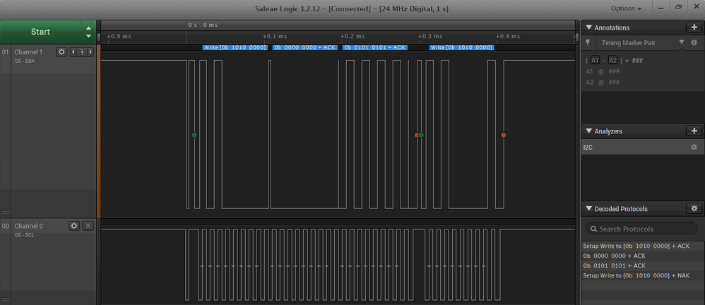

and this is a capture from Saleae analyzer:
in last lie of coding.. i set addr = 0xA1
but it as 0xA0 on Scope.  O_o!
i do not understand.
