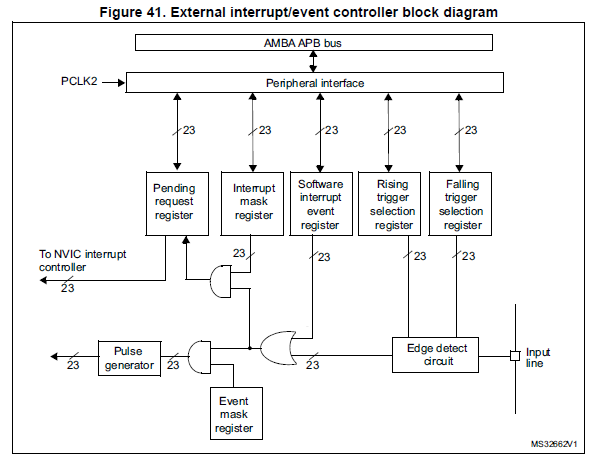

You haven't mentioned what processor you are using. If you are looking to set up an interrupt that may be triggered by software, consult your reference manual and do a search for 'software interrupt'. In the STM32F407, the EXTI controller has a register called 'Software interrupt event register'. From the reference manual: 'An interrupt/event request can also be generated by software by writing a ‘1’ in the software interrupt/event register.'

With setting: EXTI_IMR |=0x10; and EXTI_EMR |=0x10;
when i write: EXTI_SWIER |=0x10; then EXTI_PR changes from 0x00 to 0x10 (Ok)
Question: which interrupt subroutine is executed EXTI_IRQ4_ISR() ?
2017-03-05 3:26 AM
The SW interrupt replaces the Input pin.

2017-03-05 2:08 PM
P388 from RM
Take an example in cube of EXTI external interrupt with GPIO. Put a breakpoint in the interrupt routine.
Trigger the interrupt and confirm code stops. Now, open the EXTI HW register window in the debugger and manually disable rise and fall detection on that EXTI. continue the code until it goes back to main loop. Stop the code and set the corresponding SW interrupt bit. Continue the code and check if the interrupt breakpoint is activated. If successful, then the rest should be pure coding...
