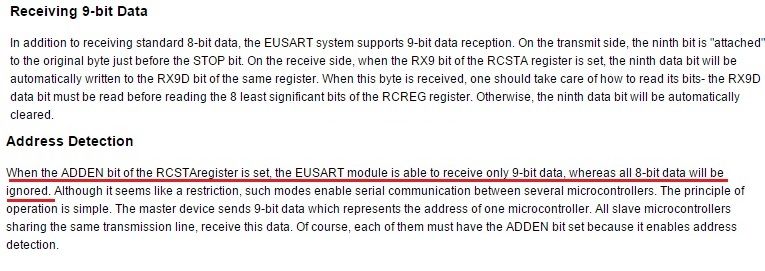

I work with Microchip PIC Microcontrollers and this feature also exist. See image below..

Sorry I must insist, there is no way for an UART to distinguish between 8-bit data and 9-bit data.
The Microchip EUSART does not work like you think. For ADDEN to work, the EUSART *must* always be in 9-bit mode. There is a convention (made in Microchip) that says address have 9th bit set and data have 9th bit clear. The address detection ignores 9-bit characters that have 9th bit clear. When the slave answer, the EUSART stay in 9-bit mode and send 8-bit character plus a cleared 9th bit. It could not work otherwise. If the EUSART were reprogrammed in 8-bit mode, the 9th bit on the wire will be the stop bit, which is 1, and the waveform on the wire will be received as an address by others slaves. The address mark detection of stm32 is similar. I did not test, but apparently it check the MSB. If you're lucky, program your uart in 9-bit mode, and the uart will only wake up to receive the address byte (only 4 LSB as address, limiting communication to 16 nodes), when the address match ''own address'', the reception continues, otherwise the uart stay idle. Read the manual. Jan: I am (probably too much) optimistic. The manual says that address matching is on 4 LSB and address mark on MSB. Maybe this will work as Rodrigo expect when the uart is in 9-bit mode: 4LSB as address, 4 don't care, and the address mark. Never tested though.We’re moving the ST Community to a new platform to give you a better and more reliable community experience.
