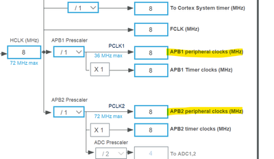

Start a project in CubeMX and look at the Clock Configuration tab to understand the various clocking options. It's in the RM as well, but is faster to get to and understand in CubeMX.

I did. I guess I am not understanding what configuration option controls the UART/USART clocks. When using STM32G4 I was able to use CubeMx to set the USART/UART clocks at different frequencies. For now, I am setting all clocks to 16MHz, but with STM32F103 I am not able locate where to adjust the USART/UART clocks to match the 16MHz. I guess I can use my oscilloscope and play around with the configurations but it would save me a lot of time to understand what is happening.

On the STM32F103, the clock feeding USART is either PCLK1 or PCLK2 depending on where the peripheral is. There is no option to change it to anything else.
