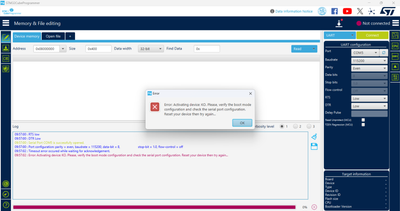

When I try to connect our module, I'm seeing the above error.

The MCU starts from the internal HSI. There is no way to check the MCU clock.
Meanwhile, are you sure about the COM number you are using? COM5?
Please check again in the windows device manager. Does CH340 module correspond to COM5?
I did the same test on a NUCLEO-F103RB board and succeeded with the same CubeProgrammer parameters as yours and succeeded to connect to the system bootloader. I got the same error when COM number is wrong.
Otherwise, I'm running out of ideas .. It could be an issue with your MCU ..

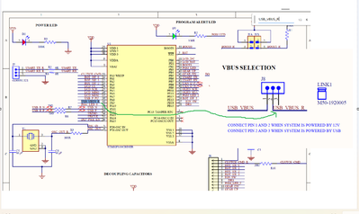

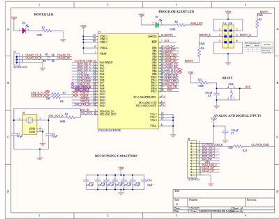

Hello, here is my schematics.
F1_STEERING_MODULE_SCH.pdf
Since our device can be powered not only by USB, in one of your document, it is mentioned we should use PA9 of VBUS sense(USB VBUS). This resulting in using PB6 and PB7 as UART. But we had a connection for PA9 and PA 10 to some header, we are using that header pins for UART line. We checked voltage levels of Boot lines that is as expected as it is supposed to be and also we checked continuity of the tx, rx lines which are proper only. We got assembled our components from JLCPCB. We checked two boards. All two boards throwing same issue.

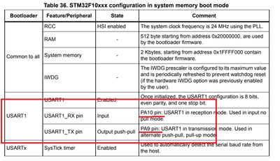

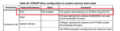

You can't use all USART IOs for the bootloader. There are specific pins for that. For STM32F103, you need to use USART1 with PA9 and PA10 no other options. Please refer to the AN2606 /Table 36:
You can't use PB6 and PB7.
From your schematics, PA9 (USB_VBUS) and PA10 (PGM LED) are used for other stuff:
So not possible to use the bootloader in a such configuration. You need to keep These IOs free for only USART and Bootloader usage.

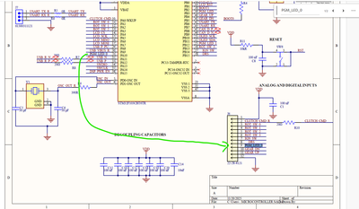

That's what I mentioned in my previous message. Yes, in schematics it is routed as PB6 and PB7 for UART. But, after reading AN2606, we are using PA9 and PA10 as UART lines. Since PA9(J8 pin 2) and PA10(J6 pin 9) are routed to some headers, it is giving us flexibility to use them as UART lines.
2025-12-08 2:41 AM
But in the schematics PA9 and PA10 are already used by other stuff. In addition to route PB6 and PB7 to PA9/PA10 you need to remove USB and LED connections from them!
2025-12-08 3:22 AM
We haven't connected those pins to neither LED nor USB to those pins. It is routed to other pins but nothing is connected.
In below image u can see that connection between microcontroller and headers.
2025-12-08 3:25 AM - edited 2025-12-08 3:35 AM

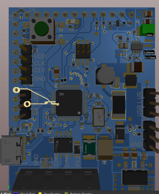

I recommend you to check again your hardware especially your connections. Do continuity tests between that "CH340" and the STM32 pins PA9/PA10 and ensure the common ground. For the continuity test you need to power off both your STM32 and CH340.

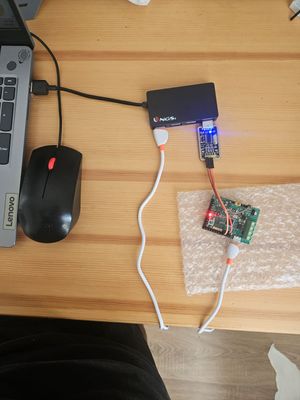

2025-12-09 2:19 AM
I did continuity test between CH340 and and PA9 and PA10 pins. Continuity is there and also I'm using common ground between the CH340 and our module. What else could be the issue?

2025-12-09 2:21 AM - edited 2025-12-09 2:23 AM
Check with an oscilloscope CH340 Tx and Rx, is there some traffic? + check their voltage levels ..
