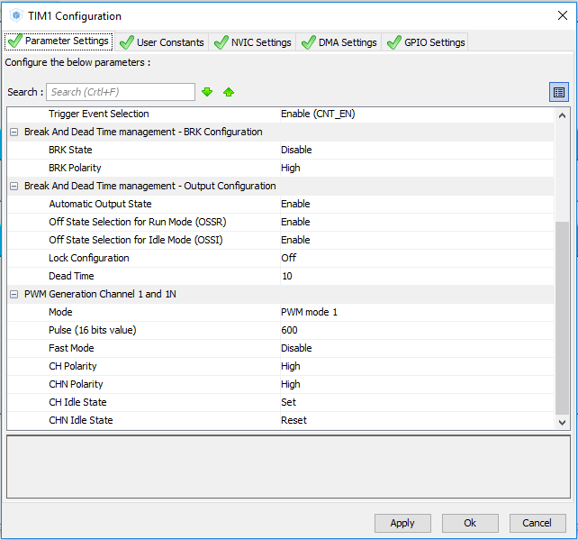

Do you need complementary signals?
Then configure TIM CH1 and CH1N and the break/dead time like this:We’re moving the ST Community to a new platform to give you a better and more reliable community experience.
