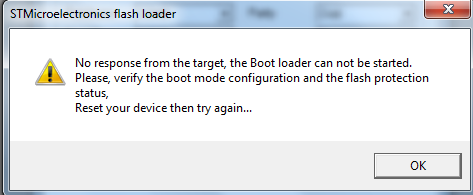

I try different Connection mode from Settings, but always I get the same error: some of pages have memory protection.

When I try connect via uart also get error.

BOOT0 = High?
Why I may send stm32f10xLoader.bin to processor while when I send different files I get error? I don't know, it's very small and designed to run in RAM? It's clearly not an appropriate file to flash into the device. If your board used to work, and now doesn't, go back in your mind and consider what you might have changed, or what might have happened too the board. Go back to the software that worked, does that work now?2014-04-02 2:07 PM
Yes, boot0 = 1.
I remember that I try send to stm32f3 demo example, next I download st-link utility and perhaps I updated st-link firmware. Is it possible to block the flash memory? Its very odd that just some of them. Where I find the original firmware to st-link stm32f3discovery?2014-04-02 3:35 PM
