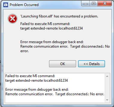

Another error from true studio.

I can erase chip but I cant erase sectors... I also have error in the other ide, truestudio. Where I may download v16 or v17?
2014-04-01 8:17 AM
Yeah, really can't help you with Atollic/TrueStudio, not my thing.

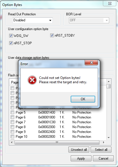

Atollic does not deal with the options bytes. If the Flash sector lock bits have been set - Atollic cannot download. You have to use the ST-Link Util to change the option bytes bits. Hope that helps2014-04-01 9:31 AM
When I try set Option bytes I get error. Any ideas what is wrong?
2014-04-01 10:41 AM
Perhaps there are other issues with your system/installation? Drivers, software, OS? Try with current drivers/software directly from ST, rather than random stuff supplied by Atollic. Try a different system.2014-04-02 12:48 AM

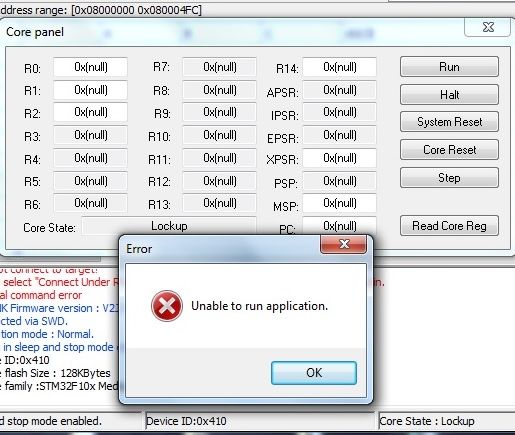

I can only send to stm32f103 stm32f10xLoader.bin from st-link folders, when I try to send the other .bin or .hex files I get error.2014-04-02 1:40 AM
Hi
Something is odd here! Does the program put the processor into any of the low power modes? (I noticed in the list output - the debugger mentions that debug in sleep mode enabled) Have the SWD pins been used for IO or a peripheral?2014-04-02 2:14 AM
I never use SWD pins. I can put program into processor in other low power modes but only stm32f10xLoader.bin.
When I put program into stm32f3 (processor in discovery board) all it's OK.We’re moving the ST Community to a new platform to give you a better and more reliable community experience.
