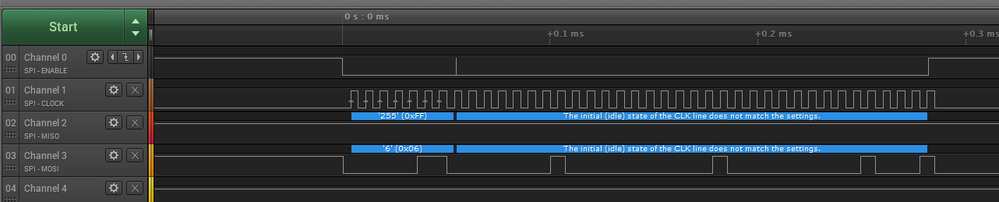

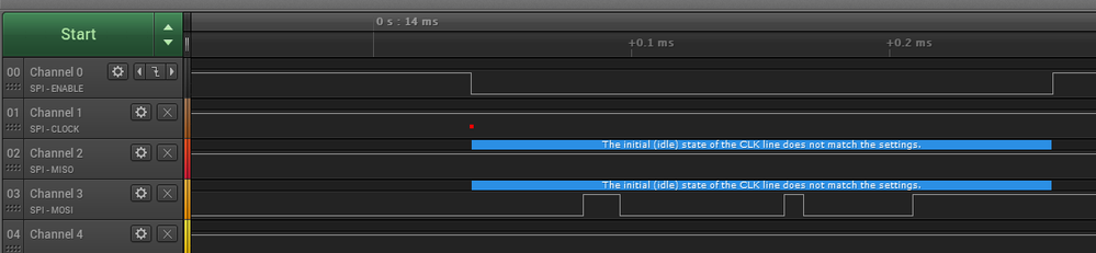

I'm use STM32F103 RCT6 SPI3 with EEPROM.
But When I use IAR Debug. can't read or Write. because no have clk
Without IAR Debug

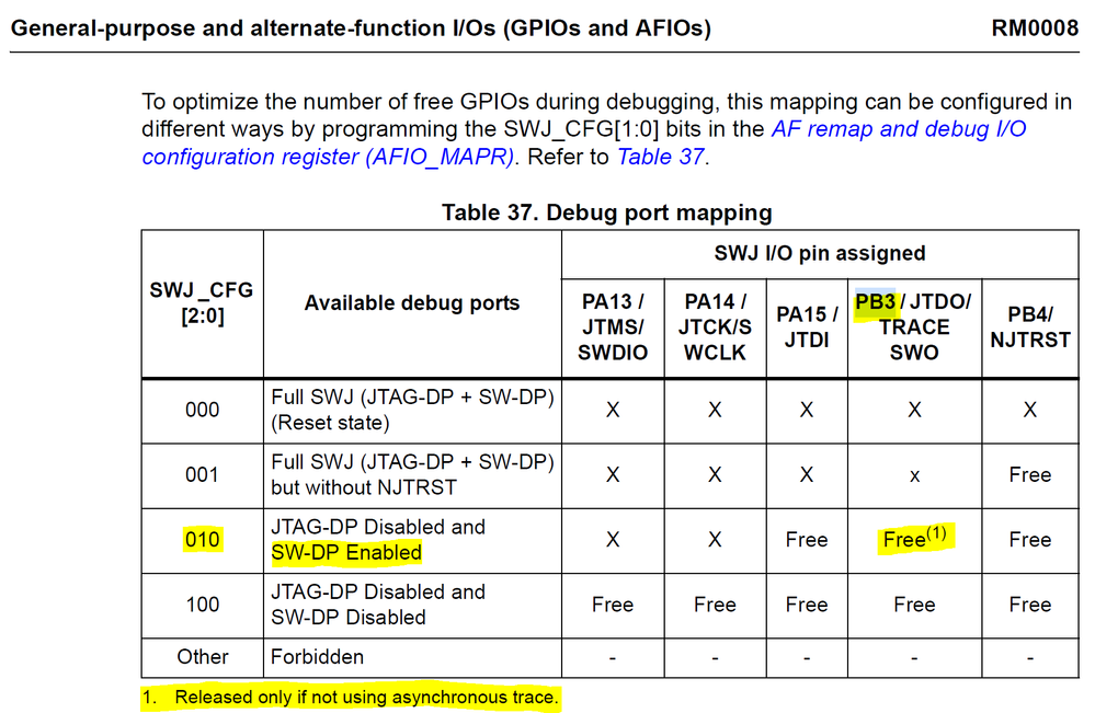

PB3 is the SWO pin (as well as SPI3_SCK). Possible the debugger is messing with this manually. It's possible the IDE has a switch to disable it.

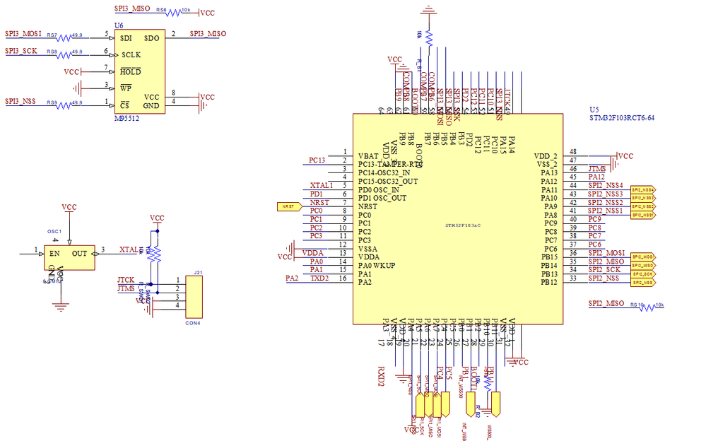

Your schematic is misleading/off. Some pin labels don't line up with what they're connected to on the top and bottom sides.

Hello? Thank you your reply.
I try remap ....
GPIO_Remap_SWJ_NoJTRST
GPIO_Remap_SWJ_JTAGDisable
GPIO_Remap_SPI3
But Same(debug mode. no have CLK).
:sad_but_relieved_face:
2021-08-29 9:12 PM
This isn't something you can fix from within your code. As I said, it will be an IDE project/debug setting. It will depend on what specifically you're using to debug the board. I don't use IAR, but I would expect it's somewhere in project settings, or debug configuration settings.
