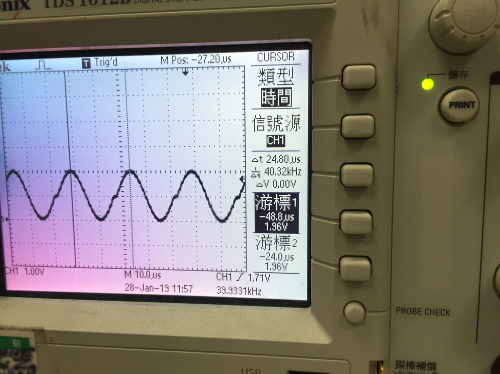

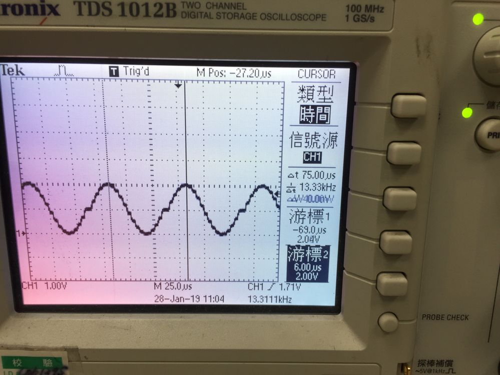

The chip I am using is STM32F100C8T6.
I want to generate a sine wave with 40Khz between 0 to 2V ,but I cant't get correct frequency.

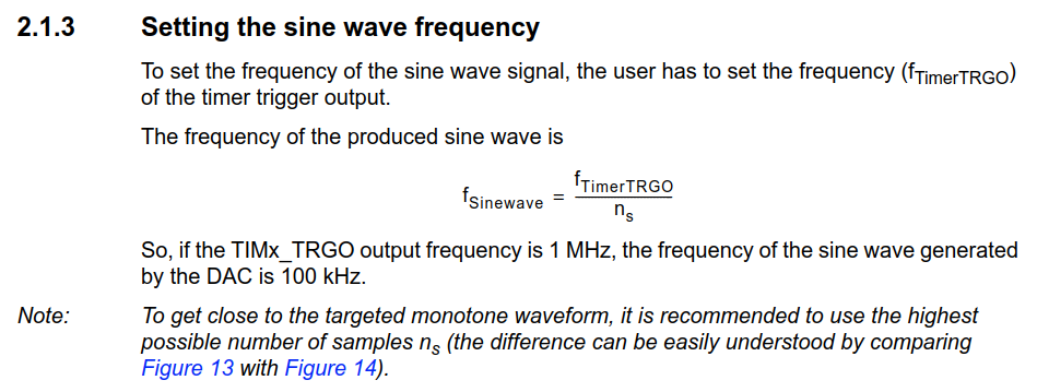

I have finished reading STM32F100 datasheet (RM0041) and AN3126,AN4566. After that,I am writing a program based on the files. what mistake did i make?
1.AN3126 sinewave equation:
fsineware = 40Khz ,ns=20 ftimertrgo = 40K*20 =800Khz
2. ftimertrgo equation:
Ttimertrgo= (1/ftimertrgo) = (TIM_Period+1)*(TIM_Prescaler+1)/TIMxCLK
TIMxCLK =24Mhz, Set TIM_Period=9, get TIM_Prescaler=2:
3.Oscilloscope 13.33Khz the frequency is wrong

2019-01-27 6:43 PM
Don't wait for HSE startup when using HSI. HSI clock should already be running.
2019-01-27 6:43 PM
2019-01-27 7:25 PM
Thanks, I get it . Thanks for your help, you do gave me a big favor.
result:
fix code:
void Rcc_init(void)
RCC_DeInit();
RCC_HSICmd(ENABLE);
//if(RCC_WaitForHSEStartUp()==SUCCESS)
//RCC_PREDIV1Config(RCC_PREDIV1_Source_HSE, RCC_PREDIV1_Div1);
RCC_PLLConfig(RCC_PLLSource_HSI_Div2,RCC_PLLMul_6);
RCC_PLLCmd(ENABLE);
while(RCC_GetFlagStatus(RCC_FLAG_PLLRDY)==RESET){}
RCC_HCLKConfig(RCC_SYSCLK_Div1);//24M
RCC_PCLK1Config(RCC_HCLK_Div1); //24M
RCC_PCLK2Config(RCC_HCLK_Div1); //24M
FLASH_PrefetchBufferCmd(FLASH_PrefetchBuffer_Enable);
FLASH_SetLatency(FLASH_Latency_2);
RCC_SYSCLKConfig(RCC_SYSCLKSource_PLLCLK);
while(RCC_GetSYSCLKSource()!=0x08){}
// else
