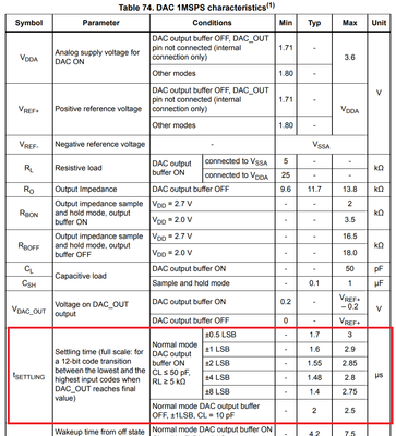

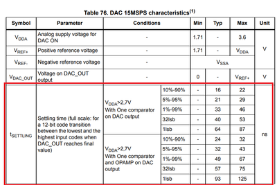

Hello, FYI,
From the datasheet:
DAC at 1MSPS:
DAC at 15MSPS:
