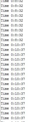

I'm running RTC on LSI Clock and transmitting data via UART2 but the RTC is not displaying updated values but while on reset it is showing updated values as shown in below image.

HAL_RTC_GetTime(&hrtc,&Time,RTC_FORMAT_BIN);
sprintf(Buff,"Time %d:%d:%d\n",Time.Hours,Time.Minutes,Time.Seconds);
HAL_UART_Transmit(&huart2,Buff,strlen(Buff),100);
HAL_Delay(500);
