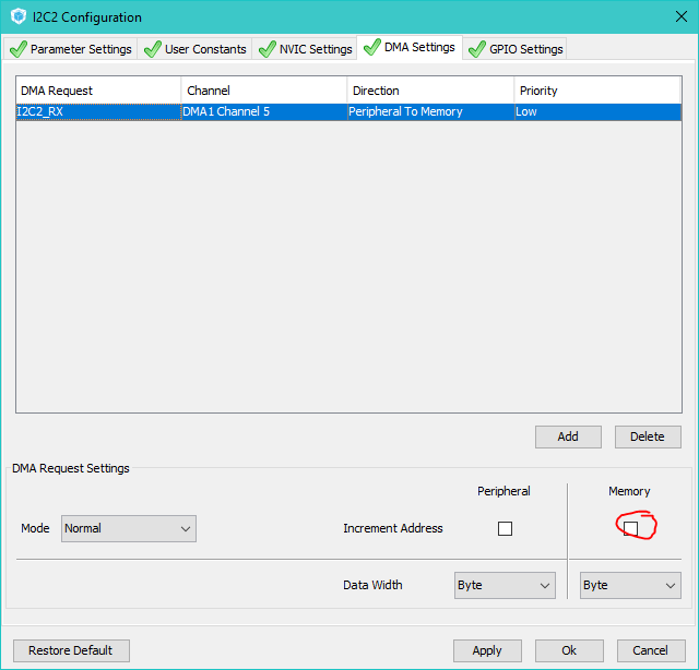

2017-09-16 9:43 PM
Well I have actually gotten to read the temp register but I can't read the other registers config, thyst and tos.
Your call to HAL_I2C_Mem_Read_IT is almost correct
correct one is
HAL_I2C_Mem_Read_IT(&hi2c2, 0x90, 0x00, 0x01, (uint8_t*)SensorData, 2)
2017-09-17 1:57 AM
Hello !
Also your I2C2 DMA settings transfers only a BYTE. to memory (the last)
Check the increment address box to transfer to ''
SensorData'' all bytes requested.
