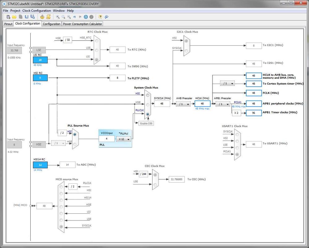

From what I read in the datasheets I suspect that I can run the timers at 48MHz. Is there a way to let the timers (a timer) run with 96MHz? I stumbled across that when I played around with Cube.

Of course not, this is just incompet^H^H^H^H^H^H^H^Hmistake of CubeMX makers.
To quote from RM0091 Rev.8, both Fig11 and and Fig12 for the timer clock say:
which in turn is a buggy PDF creator used to generate the datasheet. Rewriting this manually:
If (APB1 prescaler = 1) x1 else x2.
IMO this is clear enough.

...just what I thought. Thanks.
