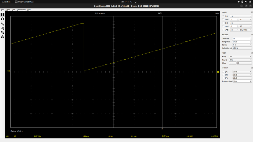

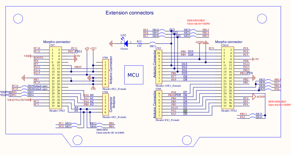

Well, turns out that PA5 is actually connected to PD13 and the signal is outputted in that pin. But I really don't know why PA5 pin doesn't show it up.

2023-09-23 11:49 AM
the same codes, except, pin_a5 is set as the output channel in this example, it also doesn't work like pa4.
2023-09-23 12:12 PM - edited 2023-09-23 12:13 PM
By the way, I suggest you to use ST tools ( CubeMX and CubeIDE). To migrate your project from SW4STM32 to CubeIDE, you can refer to the UM2579.
Best regards.
II
2023-09-23 12:12 PM
Hello, thanks for the help really, i really don't know the reason, but PA2 pin show the output in DAC and not PA5 , I really don't know why.
2023-09-23 12:22 PM - edited 2023-09-23 12:25 PM
does this output mean that i have a problem with my board ? because PA5 and PA2 are not connected in any way from the schematics.
