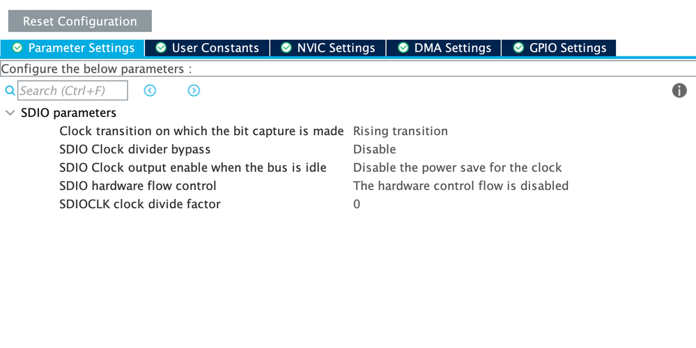

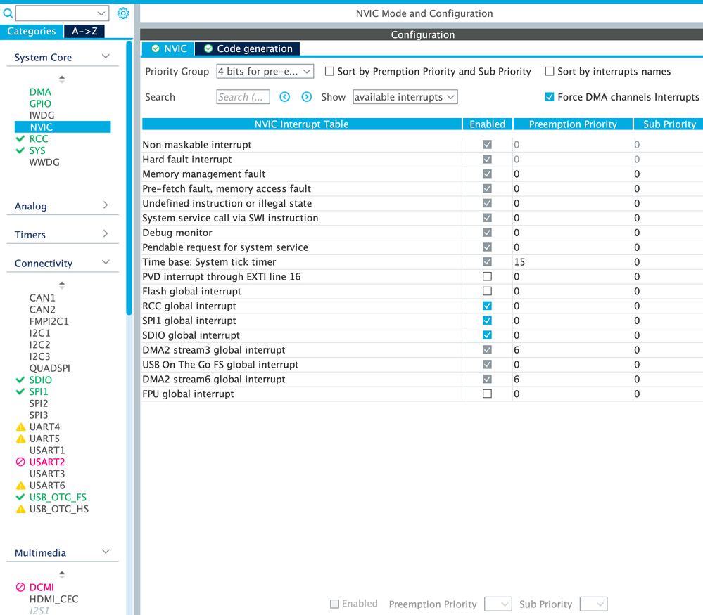

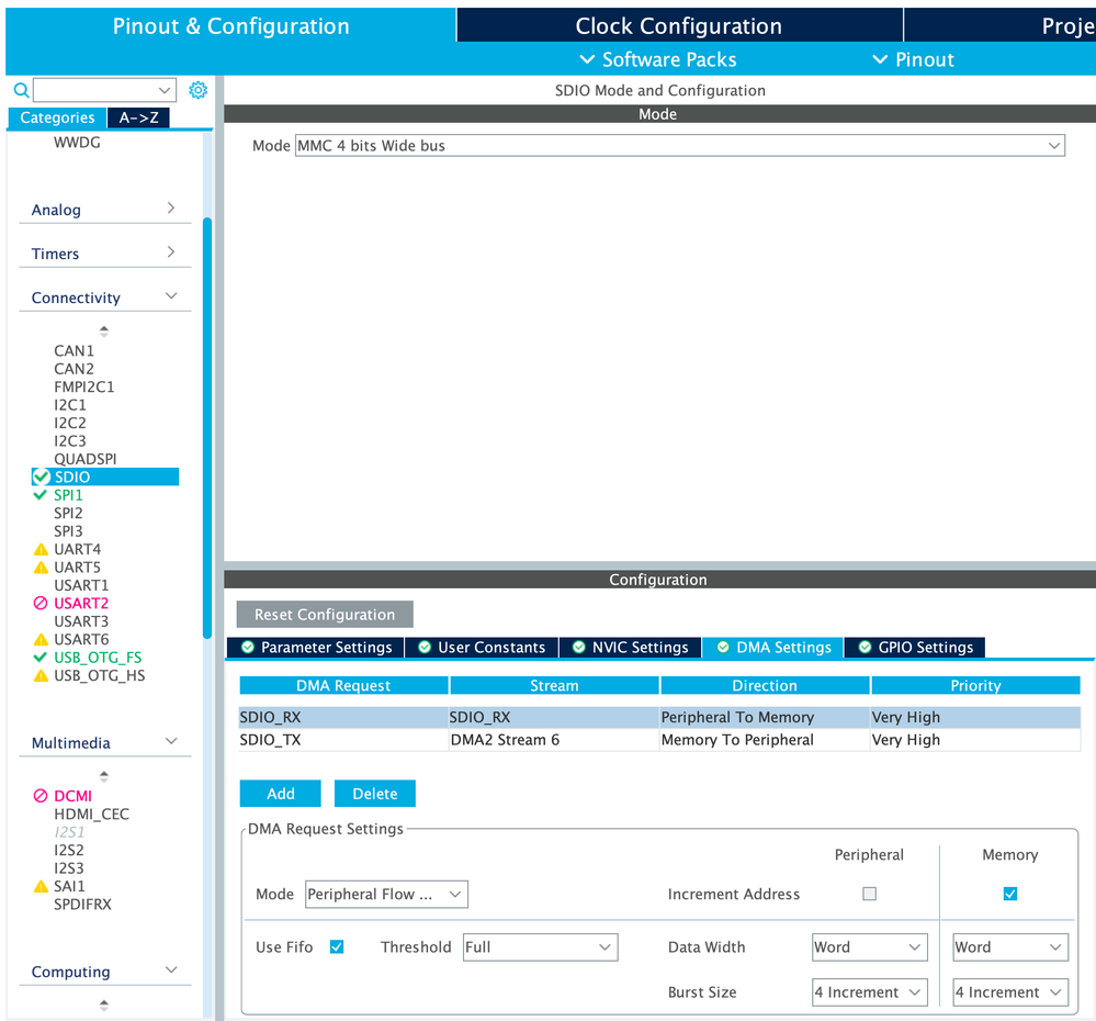

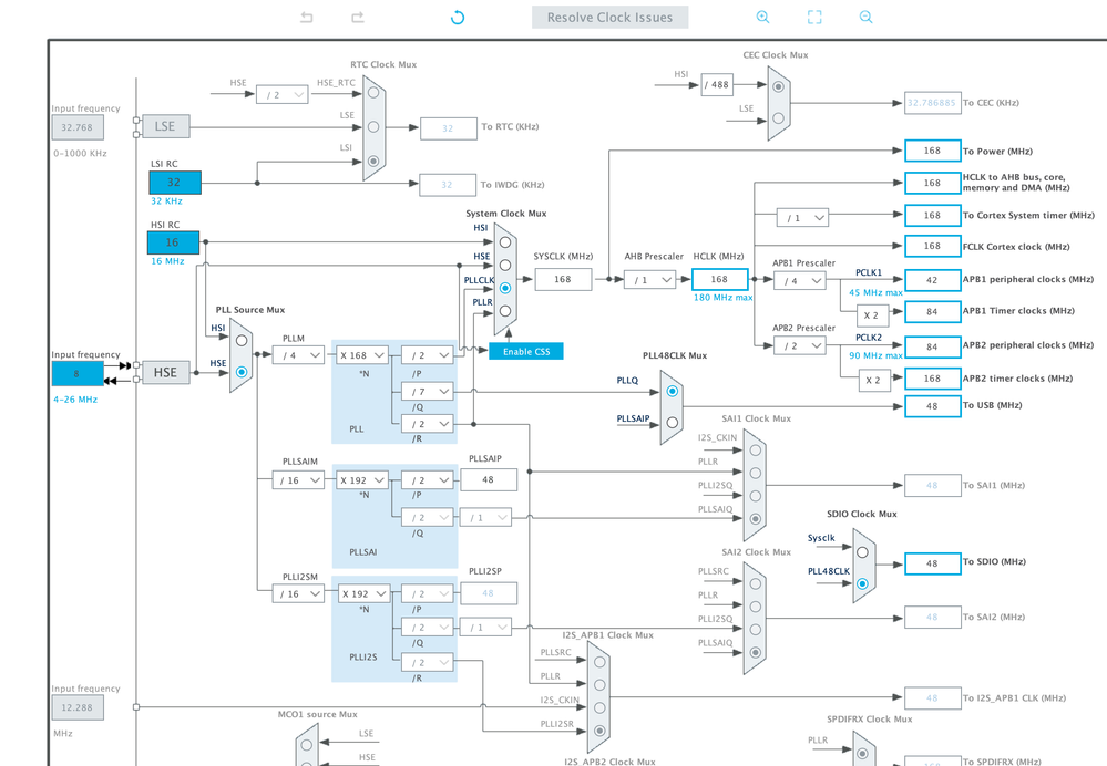

I am attempting to get the eMMC that is connected to my STM32F466RE to be detected as a Mass Storage device on the PC.
int8_t STORAGE_Read_FS(uint8_t lun, uint8_t *buf, uint32_t blk_addr, uint16_t blk_len)
/* USER CODE BEGIN 6 */
uint32_t timeout = 100000;
HAL_StatusTypeDef status = HAL_MMC_ReadBlocks_DMA(&hmmc, buf, blk_addr, blk_len);
/* Wait for Rx Transfer completion */
while (readstatus == 0){} // <- STUCK HERE
readstatus = 0;
while(HAL_MMC_GetCardState(&hmmc) != HAL_MMC_CARD_TRANSFER)
if (timeout-- == 0)
return (USBD_FAIL);
return (USBD_OK);
/* USER CODE END 6 */
