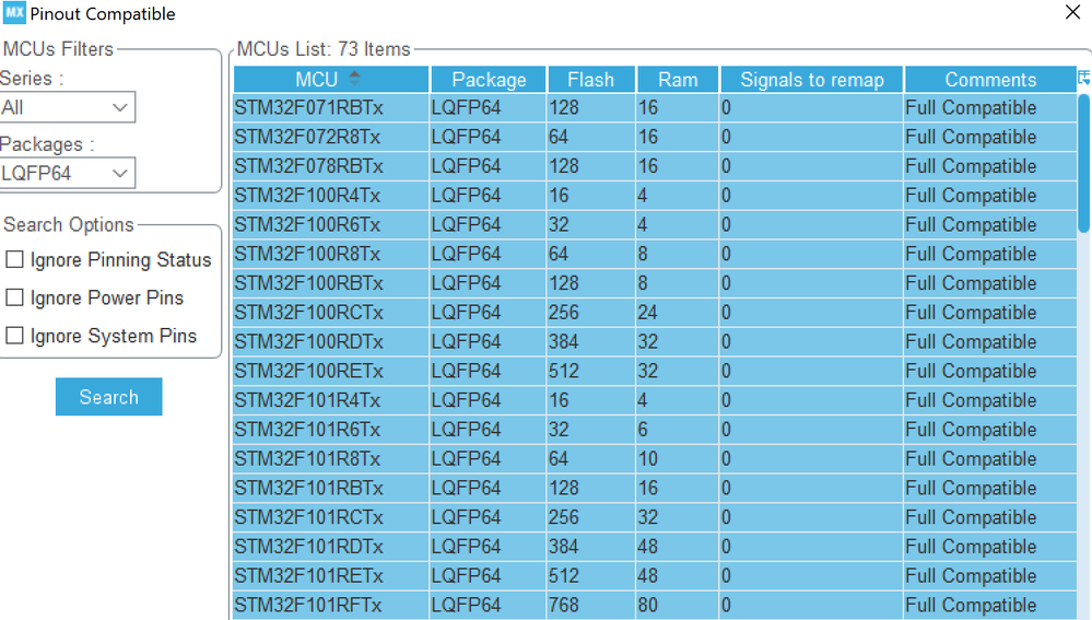

You can use the find pin compatible chips feature in CubeMX to find an alternative, if one exists. It's going to depend on your pinout.
Here's a partial list, which again, may or may not be valid for you based on your pinout.
Note also that "STM32F072RB" doesn't define a chip, since there are two different packages with that part number prefix.
2021-05-20 5:45 AM
