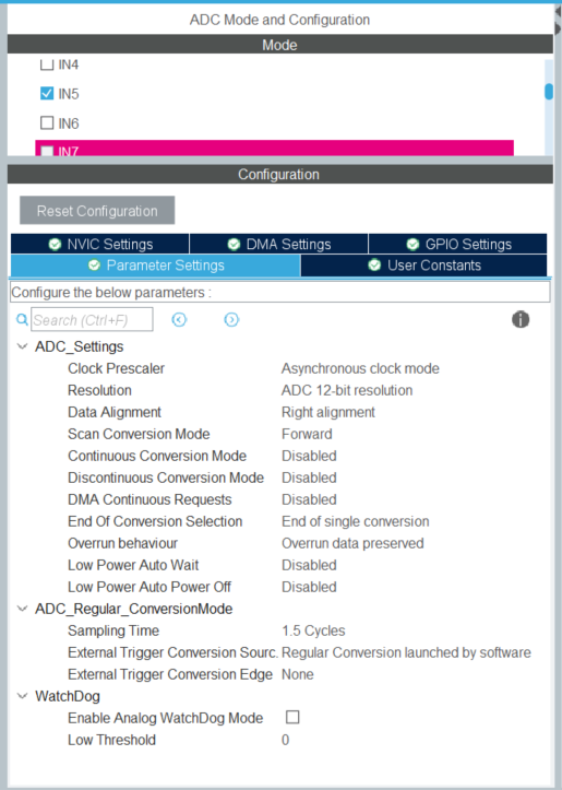

And the config:
What am I missing? Thank you!

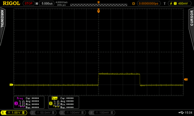

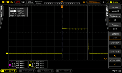

Thanks for replying, but the sampling time is not the issue. I believe there is a fundamental problem.
I have increased the sampling time to maximum anyway.

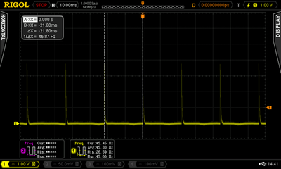

The ADC pin is going HIGH during conversion. Below is the waveform at 239.5 cycles, which match the timing on the scope considering ADC running at 14MHz.
This pull-up is periodic, of course, I am doing ADC polling at around 20ms.
But the pulling-up level is also consistent: if I put an external pull-down, the peak voltage on the pin consistently gets reduced reducing the pull-down resistance. On this case the resistor is 820R.
So, my conclusion is that there is something pulling up the pin when the conversion is started.
