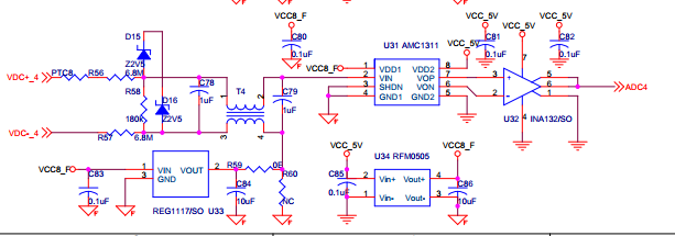

this result Iam getting for 1.382 with reference voltage 2.5 volt.
why I am getting so much of fluctuation in reading.
thanking you.

Here are tips to improve accuracy:
The sampling time in particular plays a huge role.
Is this on a custom board or known good hardware? Is the 1.382V signal high impedance?
2021-11-25 9:58 PM
yes, this is a custom board. the signal input we take at point VDC+4 and VDC-4 point, like battery or any source and the ADC4 point connected to controller ADC pin.
thanking you for reply
