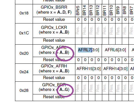

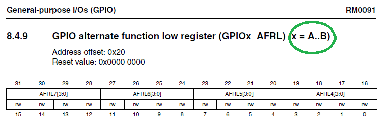

I got it working on the discovery. Now I have to make it work on my PCB. No big deal I guess. But can you tell me where you got this info from, that GPIOx_AFRL/H only works on Port A and B. Or is this just interpretation because of missing AF table to other ports? Ju2013-02-26 8:24 AM
It's marked in a couple of places in the reference manual in terms of scoping when the registers are valid.2013-02-26 9:00 AM
