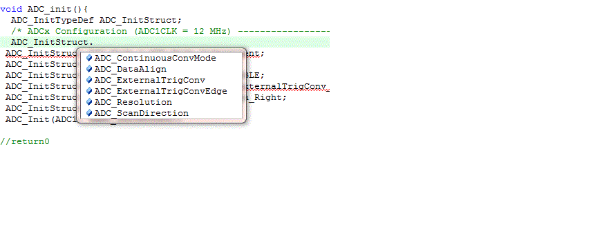

I started STM32F0 ADC configurations
select independent conversion mode (single)
ADC_InitStructure.ADC_Mode = ADC_Mode_Independent;
But my CMSIS stm32f0xx.adc.c file does not have above ADC.Mode command and also it does not have
