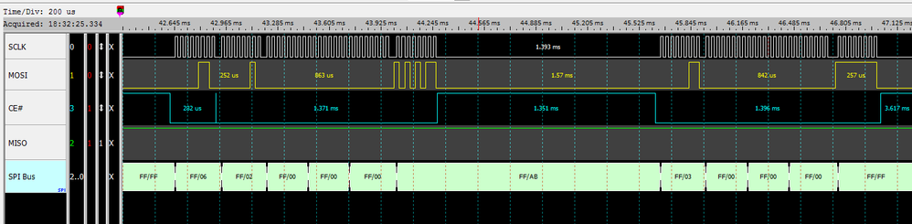

After sending the Read Command 0x3h the MISO slave pin is in High Impedance state always (No Response) using logic analyser.
I'm in the impression that write data is working perfectly please let me know if not.

Should probably look at what the CS signal is doing, I suspect HAL_SPI_Transmit() exits before the data transfers, people usually use the TransmitReceive version as it dwells until the data coming back gets clocked in. See HAL SPI example code in the Nucleo BSP files.
Thanks for the quick and helpful reply.
The following logic analyser image shows that CE# pin is low until the 8th bit last clock SCLK for HAL_SPI_Receive(&hspi2,RxData1,1,10000) function call.
Also I've checked with HAL_SPI_TransmitReceive(&hspi2,&dummy_Data,RxData1,1,1000) method. In this method i'm sending dummy_Data as 3 but still no response from MISO pin.
Let me know if anything else i missed unknowingly.
