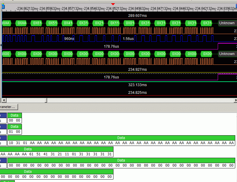

In our project we have two boards communicating with eachother through SPI. A controller board based on an STM32F405 is SPI master over a sensor board for which we have two instances. One is based on an STM32F071, the other on an STM32F031. They share the same SPI slave code (apart from pin assignment and peripheral number), but only on the 031 we experience a problem.
Once every ~10000 transactions, the SPI peripheral will not reset the BSY bit, even though it is obvious that it should. I have conducted a number of experiments which leave me slightly baffled. I have observed/tried the following:2016-05-31 6:30 AM
