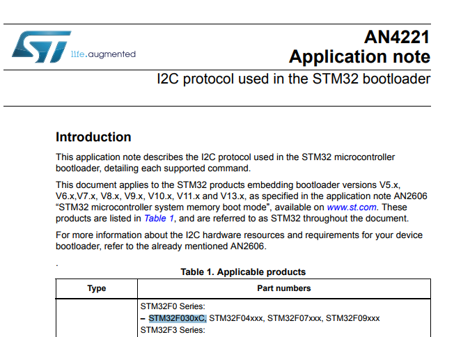

Does the STM32F030xC support interfacing the boot loader over I2C? The datasheet does not list this as an option but it is listed in AN2606 over port I2C1. Which of these are correct?

e STM32F030xC support the I2C bootloader as described in the AN2606 and AN4
