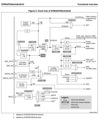

I was wondering if there is a way to set up the LSE as the source for a Timer on the STM32F030R8 to generate a PWM output signal. Currently doing a deep dive on clock configurations, timers, etc. and I have been able to use the HSE for PWM, but can I use the LSE for PWM? Maybe with RTC?

why dont you look at the clock tree, CubeMx shows you , what you can do/connect or not ?
2023-11-28 12:54 PM - edited 2023-11-28 12:55 PM
Hello @tolgaust and welcome to the ST COMMUNITY :smiling_face_with_smiling_eyes:.
According to the clock tree of the STM32F030R8 (DS9773 page 15) you Can find that the timer Can use only 4 clock sources (HSE, HSI, HSE_PLL and HSI_PLL). So you can't use LSE as clock source for a timer.

Reading the clock tree, I don't think LSE can be directly fed into a timer, so I was just curious if I was forgetting about something / unaware of some special thing to do to be able to use LSE as the source!

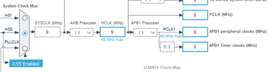

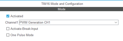

I followed a guide online on configuring a timer to generate a PWM, and set TIM16 for the following settings:
Then I selected HSE as the source on the System Clock Mux for the APB1 peripheral clocks.
Lastly, from my understanding, setting HSE source to BYPASS uses the High Speed crystal on the ST-Link debugger part of the nucleo board as its HSE crystal

In this case the HSE is the clock source of the System Clock, the rest of the clocks in the tree derived from this clock source, mainly the AHB clock HCLK and the APB clock PCLK. The timers clock source is the PCLK.

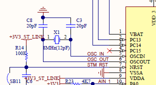

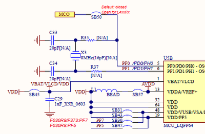

According to the Nucleo board schematic (MB1136), there is no way to use the STLINK HSE crystal (fig1 the HSE feeding the STM32F0 and fig2 the HSE that feeds STLINK)
