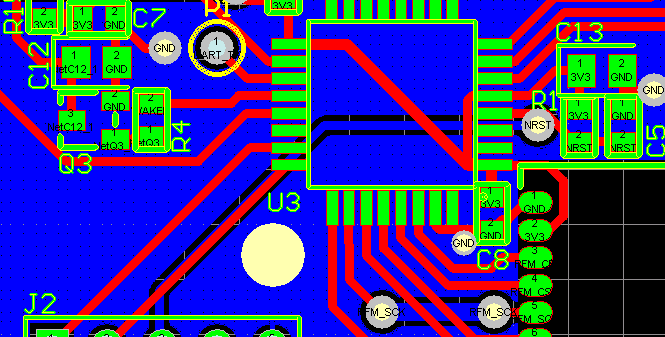

On PCB J2 is standard SWD connector. As you can see, RST is connected only to RC and J2. It is not shorted to GND and to any other GPIO.I thought may I messed somehing in ''options bytes'', but I checked, they are setup (all checked) as in working project. I'm not sure what exactly I had changed when this first happend. For sure I was adding another module in firmware. No changes in hardware.

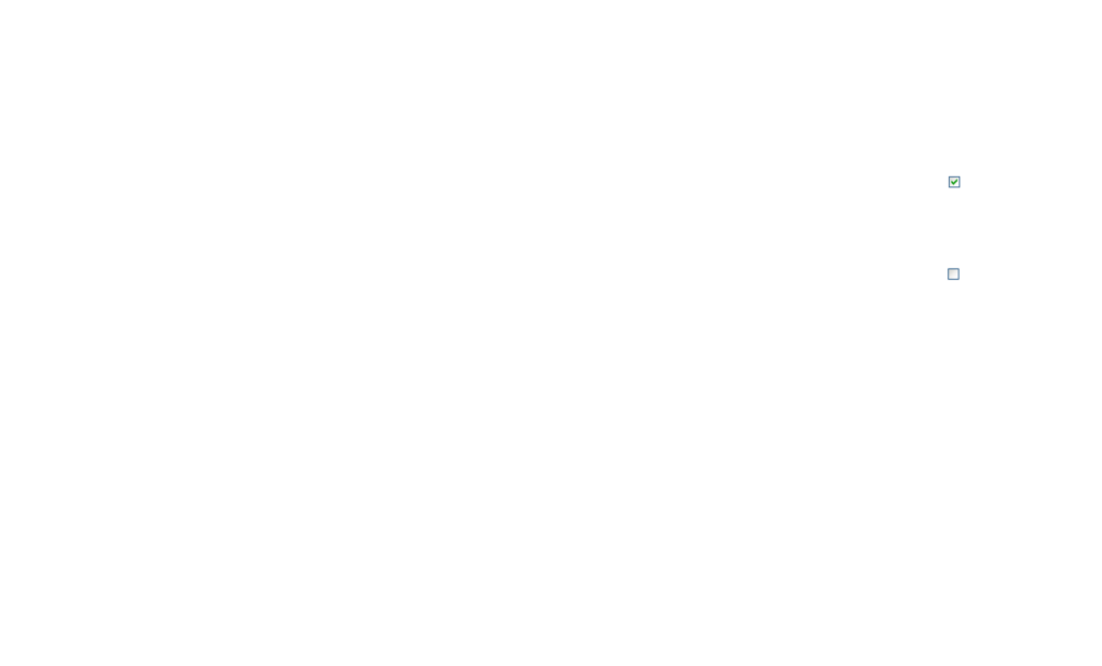

VDDA voltage

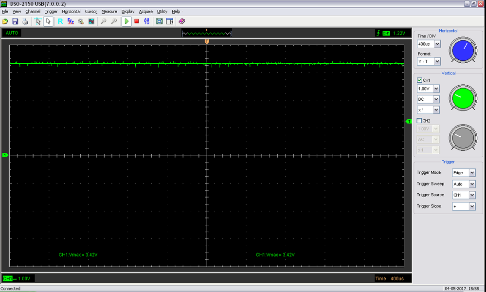

RESET signal
