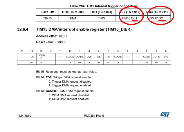

STM32F0 reference manual 13.4.3, TIM1_SMCR description, Table 45 says that setting the TS bits to 011 selects TIM17 as the trigger source. That's fine, because I want to start TIM1 and TIM17 at the same time.
However, the description of TIM17 has no mention of master timer features. There is no TRGO on the block diagram, no MMS bits in CR2.
Is it possible then to start both timers synchronized, or it's just a glitch in the documentation?

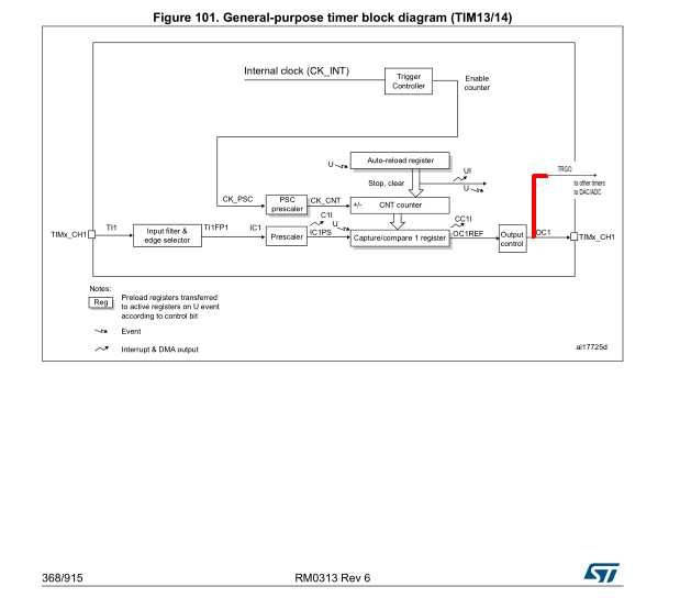

For the bloc diagram, this is slightly different as what you show below: the OC goes to the ITR. There are no TRGO outputs in these timers.
I will come back to you soon with clarification for some points.

2019-11-13 7:32 AM
Hi @Imen DAHMEN ,
Of course it *is* TRGO.
Okay you may not call them TRGO internally, but that's just more confusing for the users.
We are here talking about user experience, not your internal lingo. And the timers linking is confusing enough and poorly documented enough to add more confusion. So, once users learn that the links are TRGO-to-TRGI, it's wiser to call all the timers outputs towards other timers TRGO even if you internally call only the output from the mux so.

I went through the RMs, there are deviation in 8 reference manuals (RM0038, RM0091, RM0313, RM0364, RM0365, RM0366, RM0451), i.e. TIM16 is mentioned instead of TIM16 OC. The timer specs with be corrected (but the corrections will be visible only when the next RM update will be triggered):

Yes, I confirm the 2 timers can be synchronized.
The STM32 timers with one channel only (i.e. TIM10, TIM11, TIM13, TIM14, TIM16, TIM17) do not have the circuitry to act as a master: no TRGO output, nor MS programming bits.
Still, they can be used as a master using their output compare output (e.g. tim17_oc), when it is connected to the ITR input of a slave timer (here TIM1).
The only point to care about is that there are 2 clock cycles delay between the starts due to internal synchronization. The 1st trick is to initialize the slave timer (here TIM1) to 2 instead of 0.
The 2nd point to take care about is that the TIM17 output will be set as soon as the MOE bit is set, before starting the counter. This can cause some unpredictable offset. To avoid this, the (pseudo) master timer must be started with a null duty cycle. The whole system will start (synchronized), when the user will write a non-zero duty cycle in the master.
I have to admit this is not obvious, we will have to document this behavior.
