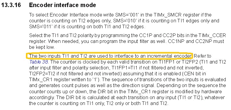

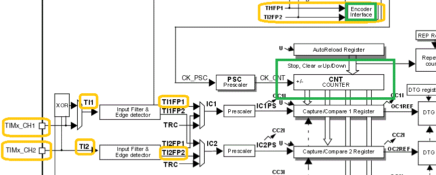

I think you got me wrong, I know how to find the pin associations. But I did not find the information for it's working only on CH1 & CH2 of the timer. Can you help me?2014-12-01 4:13 PM
Ok, let me go dig that up.
