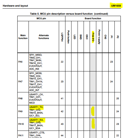

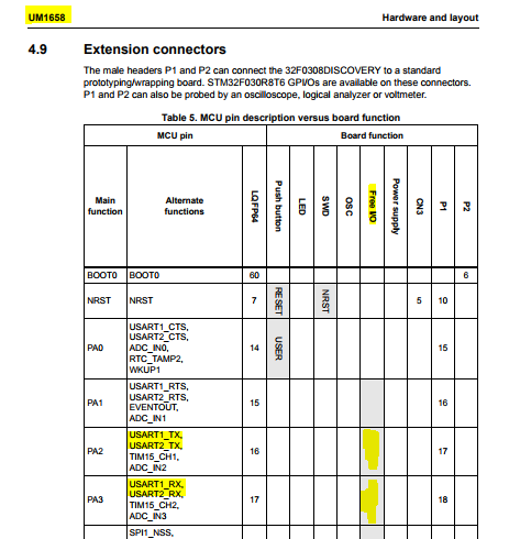

Hi to everyone!
Checking the user's manual of the discovery board there shows that the pins that you are using to uart are free, pages 19 and 20:
By the way, the right pins are PA9 and PA10, there you havean issue.

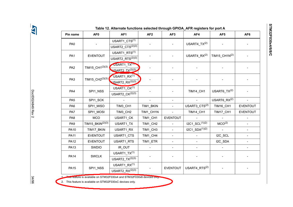

According to the document provided by
Turvey.Clive.002
, there should be ( see below ). Or am I misunderstanding?I have also tried using USART1 and PA9 and PA10, which should work according to the table below, but I have had no luck.

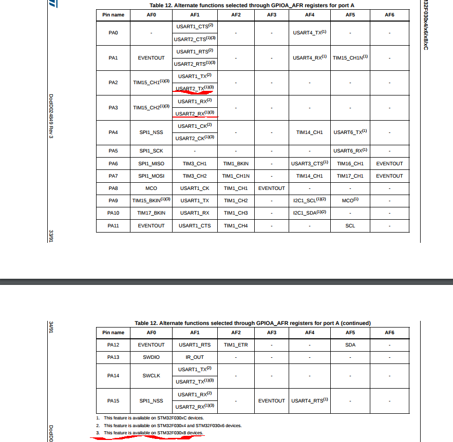

2017-08-24 7:40 AM
I apparently have an older version of DS missing the footnote 3...
Then USART2 on PA2/3 should work.
As Clive said, make sure the pins are free on that board. Check them as GPIO Input/Output.
What's written on the chip and what is its ID readout?
