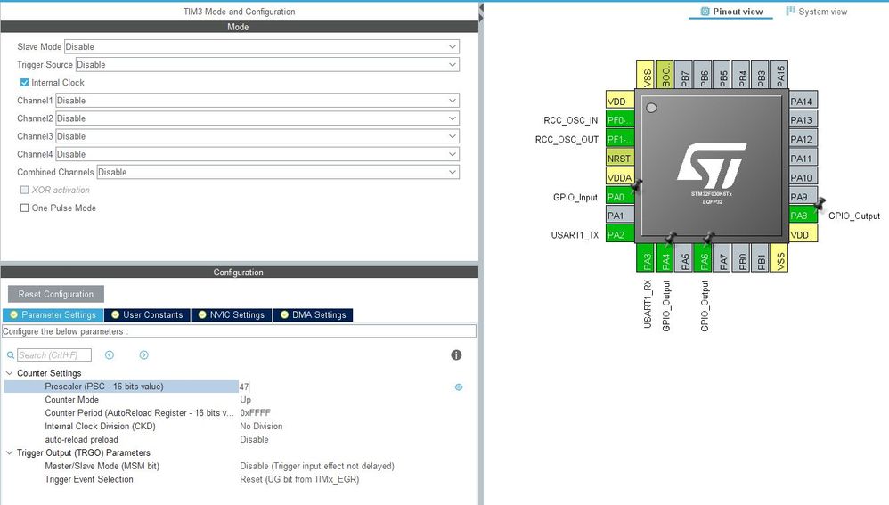

Thank You, Please check my CubeMx config, is it correct?
my HCLK = 48Mhz
2019-11-16 11:07 AM
Looks reasonable, not using CubeMX here. Likely some timebase examples under the HAL CubeF0 trees also
